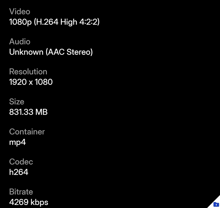

I’m also getting the same error playing back H264 4:2:2 on Android app.
The video plays fine on iOS and on Chrome. (Both direct play and transcode)
