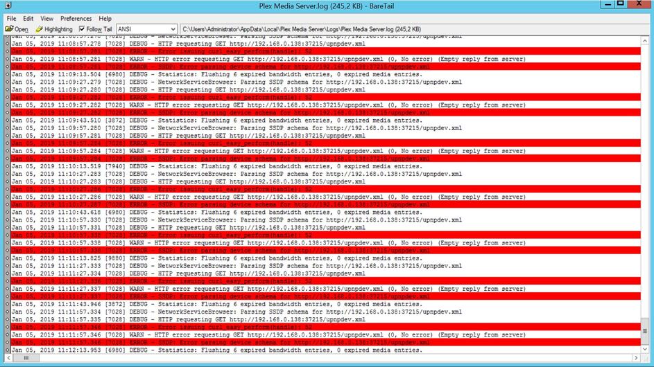

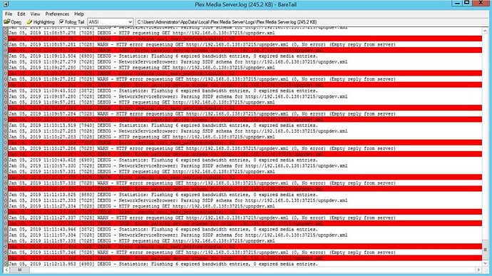

Is there maybe any chance of getting rid of those GET queries to 192.168.0.138 by adjusting other settings?
I’ve attached a screenhot of the current logfile and I highlighted all errors. Is there anything else I can tweak to avoid those errors in the logfiles?
But as I already mentioned, I want to point out that Plex runs very well and this is only because I am interested in how it works. Currently I do not have any issues with it.
Appreciate your help,
Thanks again!
Unfortunately not.
