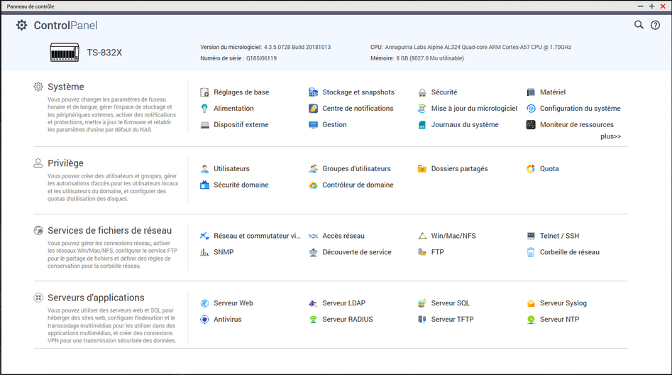

Notice the fields are not filled in?
This might be a firmware bug.
Also notice on 4.3.5.0722, it is correct.
This is mine :
Try to resize your windows with the mouse, it’s a glitch :wink:
