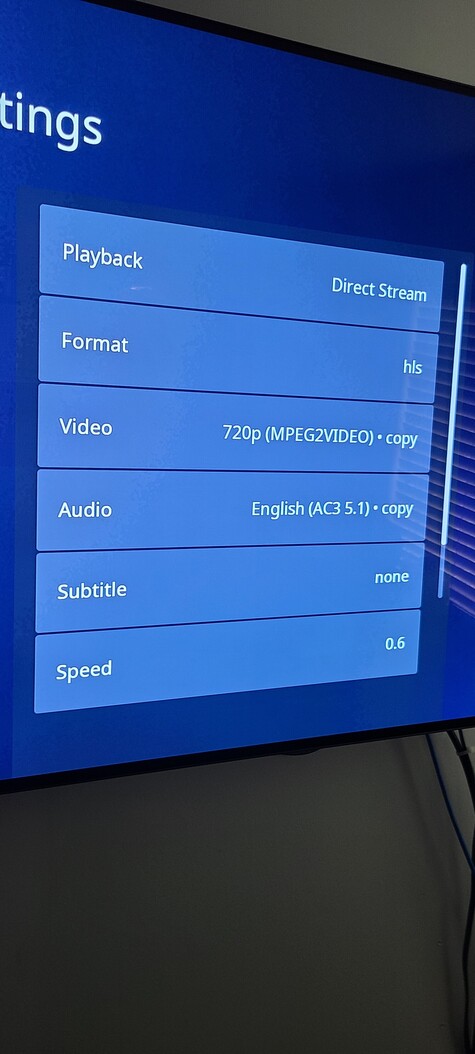

On that note, we have still been unable to replicate this behavior. The one thing I noticed in your screenshots is that your server is showing a 0.6 speed while copying. It’s possible the server is not keeping up with the transcode. One change here (in the preview) is that a transcode session will be used because seeking MPEG2 during direct play does not work on the Roku. This has always happened to fix that issue, but we didn’t catch the edge case when users select “force direct play”. Roku cannot handle direct play MPEG2 properly, so it’s not allowed any longer.
Will do I will enable remote logs and let you know when it happens. I can definitely replicate it in preview. Yeah I brought that out there about two years ago I thought it was odd that it has .6 set as the speed but this has always been like this:). My server should be plenty strong it’s on a 10-gig network switch, all hard-wired I-9 10900k with 1070. I was able to no longer Force direct play as it’s just a hiccup because Roku reports that uses 10 to 20 gigabytes for live TV it causes me to go over my allotted 800 megabit cap. Removing this fixes that problem.
