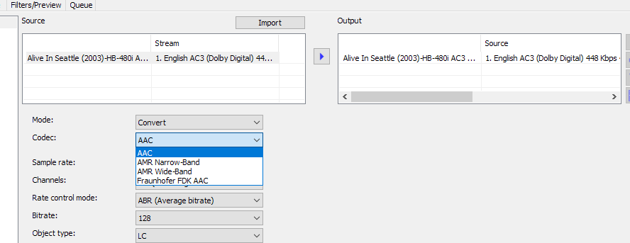

ok, I’m confused again. I thought by using Xmedia Recode, I would be following your instructions and keeping the Codec at AC-3, but the only options it gives me are shown below (4 options)? Maybe you could give me a screenshot of your XMedia Recode settings (I’m missing something in the translation). I tried other .mkv files and none of them allow me to chose AC-3 as the codec. Also, how do I normalize the audio…that wasn’t evident either. thanks!
ok, I found the Codec for AC3 by changing the Profile in XR., but there are a bunch of them. What Profile should I begin with? AGain a screenshot would be helpful. thanks. still can’t figure out how to normalize the audio.

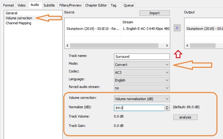

Well, that is truly strange, but XR can confuse itself sometimes - graphically.
Grab the window at the red arrow and just drag it down a bit - see if your Volume comes back.
Other than that - I don’t have a clue.
PS - always give your audio a language and after you select it once, it remembers until you restart it.

You’re using the latest XR - Volume features are - somewhere else. Over there in ‘Filters/Previews’. I found it a PITA - especially so when ur doing about 10 at a time - so I backed up to Version: 3.4.5.2 <—pre-dumb-ass version:
https://www.xmedia-recode.de/en/version.php
at least we’ll be on the same page and apologies for not remembering that - old age? Too much ‘medication’? Not enough? Who knows…lol
ha. well, that xplains it! thanks. I did a quick look and found it…does seem like a pain being over there!
Oh, it is.
Single files are fine, albeit only slightly painful. Multiple files are ‘run from the building with your hair on fire’.
3.4.5.2 is the version right before the pain started - and I can find no fault in it. For what we’re doing.
