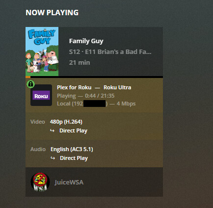

Happy to get what ever info I can. That is why I said I was new to all this. My brother is much better at the software side of things. I will try and get him to pull all the info requested.
A’ight… also reveal what the Dashboard Details look like when playback is failing - if possible:
Will get that as soon as I can. Thanks!

Let’s see the MediaInfo for one of the misbehaving files.
Let’s see what the Dashboard Details say while a file is misbehaving. <—if possible.
That should aim us in a direction, at least.
