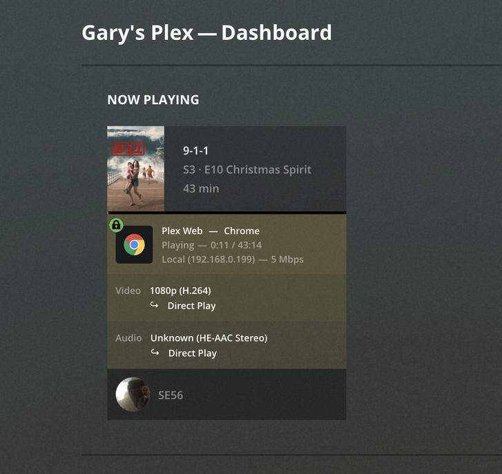

As per attachment when playing something, in this case via a Browser

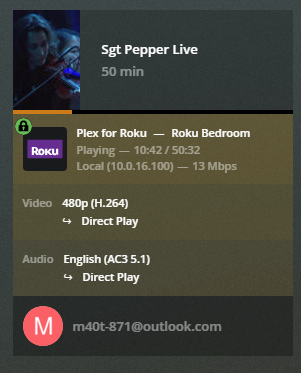

So I did the following on the Wired Roku: Checked the box to “Allow MPEG-2”. Set the Quality to “Original”.
The results are as follows.
It seems that this has cut in half the time to switch chapters for lower bitrate movies. The higher bitrate movies still take 4 seconds.
What is odd is that the higher bit rate movies now play flawlessly, yet the lower bit rate movies stutter during playback. Very odd. so these settings will not work.

You don’t get Direct Play - ever.
There’s your delay.
It takes time to mux those streams into a new container and nobody does it more than Roku, for some reason. It takes more time to mux the video into a new container while transcoding a high bit-rate item’s DTS audio track into E-AC3.
