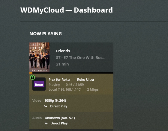

I just received my Roku Ultra and finished setting up Plex Channel and I am encountering the following problem: no matter the settings, my Bose Cinemate gets LPCM 2.0 instead of surround sound.
I am streaming surround content from my NAS (WD) to the Roku Plex Channel.
Here is what I see from the NAS Plex Dashboard
(https://aempf32337.i.lithium.com/t5/image/serverpage/image-id/1960i3973BACA6776129B/image-size/large?v=1.0&px=999 “Plex.PNG”)
Also in the Plex app on the Roku, under streams, it recognizes the right audio track.
What am I missing?

A Roku 4670R cannot convert AAC5.1 and keep surround sound. It can downmix to 2ch audio, so since this file is Direct Playing audio, the Roku will be outputting 2ch audio.
The Roku should be asking the PMS to convert the audio to AC3 5.1, if your setup supports 5.1 audio.
Reasons why that conversion may not be happening:
  1. You have set Direct Play in the Plex for Roku settings to forced. Make sure that is set to Auto.
  2. Volume Mode is enabled. Make sure that is OFF. During playback, press the * button to bring up the roku overlay and turn off Volume Mode. https://support.roku.com/article/226802507
  3. The Roku is not detecting surround sound capabilities or is set to stereo. In the Roku setting, make sure Audio Mode is set to Auto, and HDMI detects DD or greater. If not, set it manually.

Indeed, I foced direct play as setting it to auto resulted in no sound. However, having had your kind reply I looked a bit more into this and found that because my settings for output on the Roku were to auto, it recognized DD, DD+ and DTS but my bose has no DD+ capabilities.
Setting the Roku out to DD, DTS (no DD+) resulted in finally getting DD5.1
