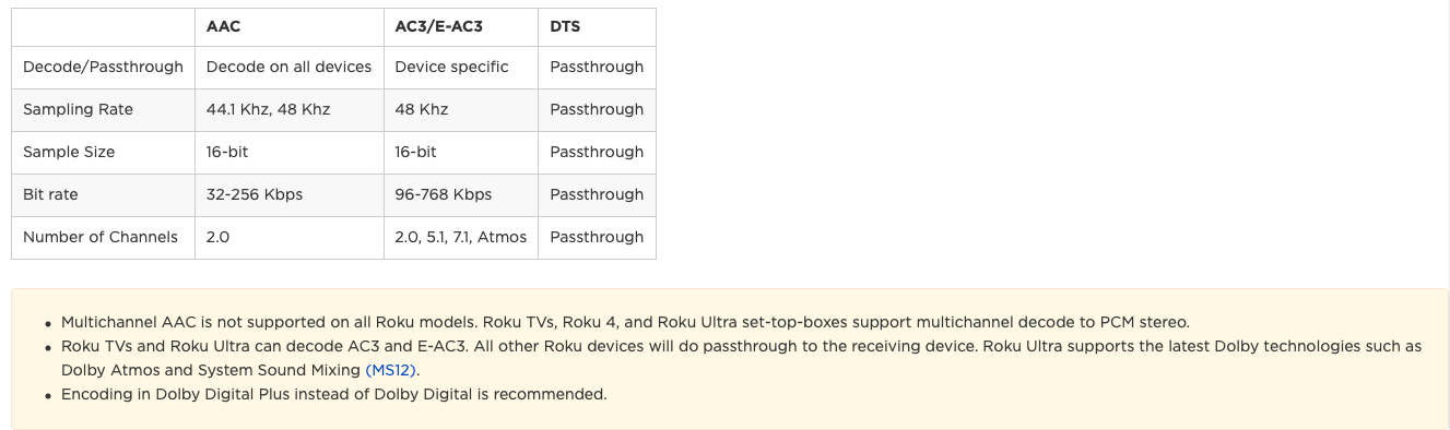

No Roku devices support multichannel AAC; such streams must be transcoded to a codec for which it does support it, such as eAC3. This doesn’t explain how it’s working for your AAC 5.1 streams however. Maybe it’s being decoded to stereo, per the second sentence in the first bullet point.
If you don’t want them to transcode in realtime, you’ll need to convert them beforehand using a tool such as HandBrake.
Thanks for the table. This makes sense and confirms my suspicions. No multi-channel AAC on Roku.
I also don’t know why AAC 5.1 direct plays but agree with you that perhaps the Roku Ultra client itself can downmix 6 channel AAC to stereo so it still reports “direct play”. My soundbar only reports “LPCM” not 2.0 or 5.1 so I can’t verify. 7.1 channels is maybe too much for it and it needs the server to do a full transcode down to stereo.
I can confirm that my Roku TV emits stereo when decoding AAC 5.1 files, as tested in other apps.
