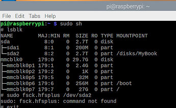

Hello so I am complete on my Plex Server but I am assisting a friend and I have made it to the sudo fsck.hfsplus /dev/sda2 command but I keep getting an error message that the command is not found. Here is a screenshot of the lsblk command and results, as well as the error message.
I have also ran this command non as a superuser. Same result.
Any ideas?
I believe that fsck.hfsplus is included in the hfsprogs package in Ubuntu. Try installing that package and run the command again:
sudo apt update && sudo apt install hfsprogs
That seems to have worked, very strange how it was in my install but not his. I did the exact same steps.
Thanks!
