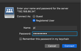

When I am logging in on my Mac, I am logging in with the username Pi

So is it possible to log in through my Mac as a root user? pi is defined as my login when I log in with my Mac.

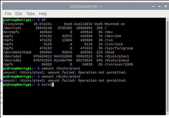

Another novice issue, I am trying to unmount the drives so I can run the first few commands, but I keep running into this issue.
How can I unmount?
Try sudo umount /disks/plex1 instead. Unless you add the user option to your mount options, only root can mount and unmount.
It says ‘Target is Busy’.
I suppose I could just power down and disconnect the hard drives…then power up without them.
That means that the mounted directory is in use. Make sure to disconnect from your Mac if haven’t already and that you don’t have any terminals open to /disks/plex1(2).
