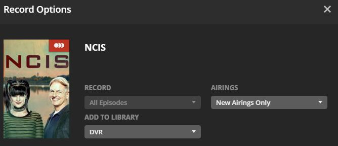

I have two shows (Bull and NCIS on CBS) scheduled to record all episodes/new airings only (screenshot attached). I set up the recordings this past weekend (11/18) and confirmed in my server’s recording schedule that both shows were scheduled to record new episodes last night (11/21).
This evening, I found that neither show was recorded and my server’s recording schedule for yesterday no longer displays either show (screenshot attached). The two shows are still configured to record in the future and still appear in my recording priority list. There were other shows scheduled to record last night and those shows did record successfully and also still appear in yesterday’s recording schedule. There were no more than two shows scheduled to record at the same time (including the ones that disappeared). Additionally, the shows that disappeared were ranked higher in the priority list than the other shows scheduled to record last night.
