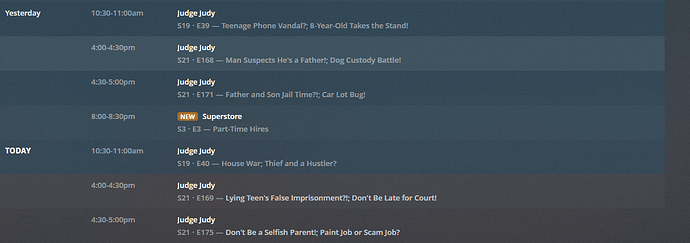

One Note, in my screen shot, Super Store recorded properly but I deleted it after watching it. All the rest say they recorded but either deleted right away or never actually recorded.
Still not recording. It looks like it is going through the recording process.
Trying to record Judge Judy at 4:00 and 4:30.
Edit:: 5:36PM

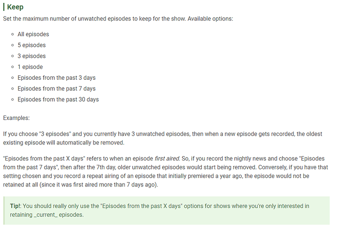

@flynn2k Since you found the garbage collection message I don’t even need to check the logs. You have the show setup to only keep episodes that are 7 days old. Plex uses the episodes original air date when determining if a show is older than 7 days. S21 E175 originally aired on 05/24/2017 so is more than 7 days old.
You can review the recording settings options in the Plex Support pages: https://support.plex.tv/hc/en-us/articles/226074728-Setting-Up-Recordings

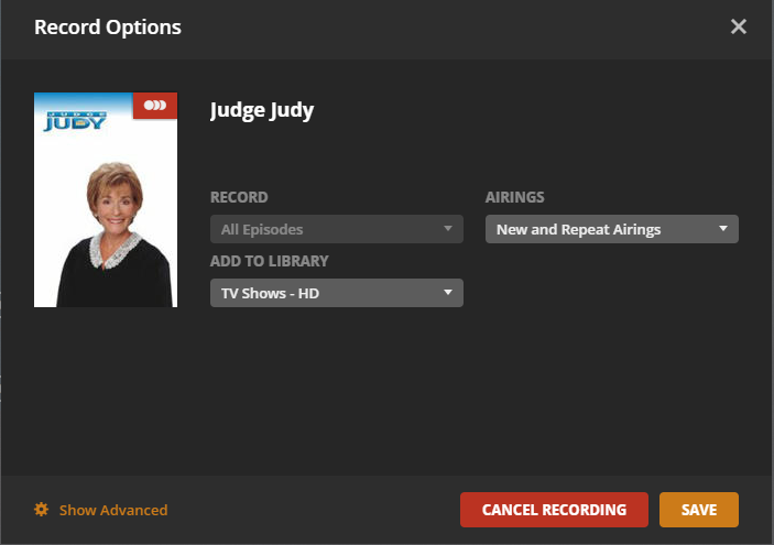

@johnm_ColaSC Thanks for the reply but I think I have it set right in the Recording Settings and that is why I am so confused. I originally had it set to keep the last week’s of episodes and then changed it to keep all but it does seem to work. If there is another place to make the setting other then on the Series Recording Manager and in Advanced, I haven’t been able to find it yet.
Thanks again.
You have it set correctly in the Recording Settings but Garbage Collector uses the settings for the Show in the Library. Go to your Library, Click on the show, and click the Edit link.
