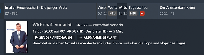

Hello, I scheduled a weekly series Mo-FR, called “Wirtschaft vor acht”. EPF Data ist telling me, existing and planned but this does not get recorded. With the last two weeks on only two days, I don’t see a pattern. Another series once a week record also did not get recorded.
I deleted the schedule an programmed this new, no change same issue.
Screenshots,
today should be visible bevor Tagesschau, nothing
from the EPG “recording planned”
an in the right field series “no broadcasting”

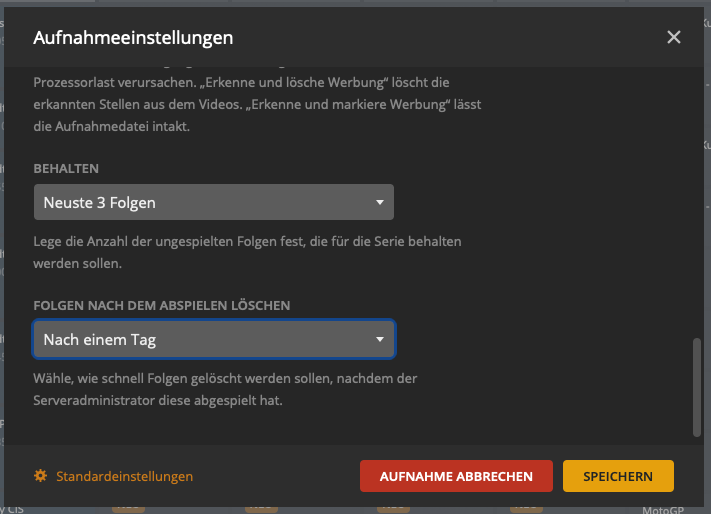

as you see my standard in some cases was : keep the newest 3 recordings and delete these after playing one day later.
This will result in “recording” the series and after it is completed not moving it in the directory ut deleting it immediately.
I changed 3 series to these settings:
and what to say, all three recordings were saved in the series directory.
So it would be nice if the support is supporting this and eliminates the bug. Thanks
Hello, since the last changes “keep all” and “never delete after played” all recordings took place and are ready to play. No loss of recordings.
