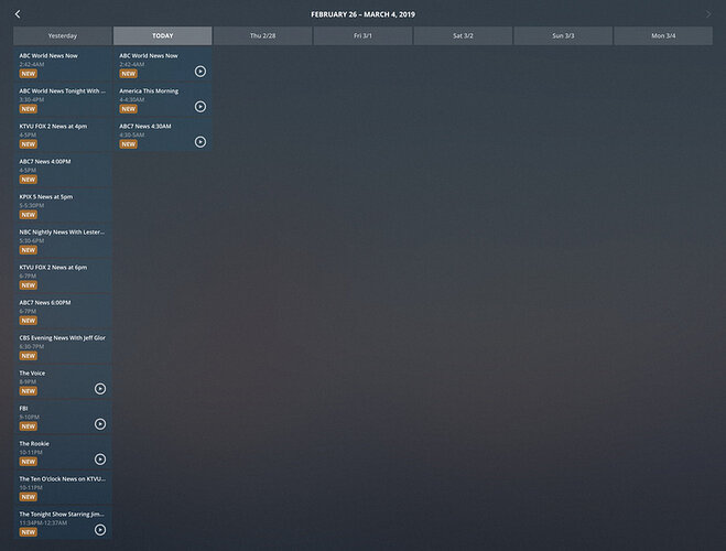

It appears as if none of the recordings have a recording indicator in the guide. The show, however, is listed in the EPG.
The recordings section reveals the shows to be recorded are missing as well.

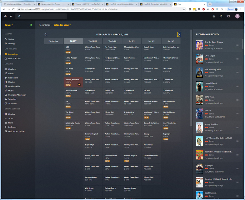

here’s screenshot of my recordings schedule

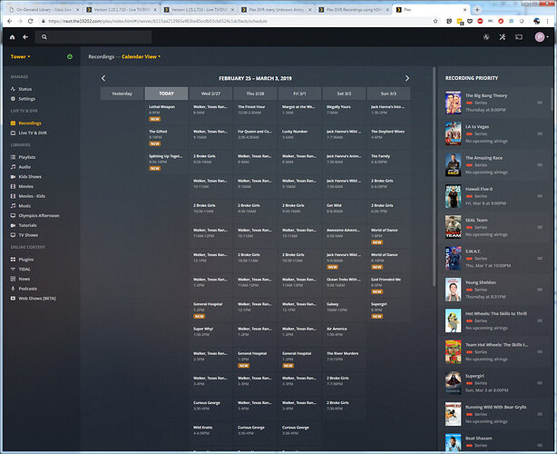

Just went to check the recording schedule again and most of todays recordings are gone! attached are my logs as well.
Plex Media (1.6 MB)
It appears I can schedule an individual recording, but not all new recordings.
@shermanh4, glad someone responded…I have an update to my findings. plex wouldn’t let me post 3 consecutive times until someone else did.
It looks like todays scheduled recordings reappeared. although I’m not sure what changed. Initially I restarted Plex over an hour ago, then it did a scan of the tvguide…I then did an on demand record and that appeared to keep, but scheduled recordings didn’t show. I did another tvguide scan and the scheduled recordings started to appear. Hopefully that will be the end of it. But I’ve attached the logs for the current time period if there is some interest.Plex Media Server Logs_2019-02-26_13-30-16.zip (2.4 MB)
