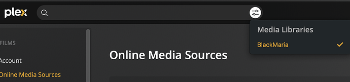

Is this checked, for you?
You may need to click in the text field first to have that button show up. Then, let me know if your server is on that list, and if it is checked.
Yeah. My server is checked there as well.

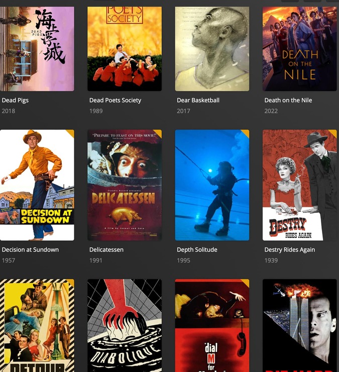

Thanks for the responses. And sure, I did that. But I still can’t search what I actually have on my server. Let’s see if I can show you.
This shows that I have the movie: Destry Rides Again (fyi, it doesn’t work for ANY of my movies).
This shows I’ve disabled pretty much everything but what’s on my server and live tv.
Got my server ready for searching.
But Nothing shows up.
Nada.
Thoughts?

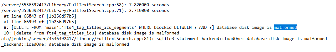

Your database is corrupt
Screenshot (2550)
https://support.plex.tv/articles/repair-a-corrupted-database/
https://support.plex.tv/articles/202485658-restore-a-database-backed-up-via-scheduled-tasks/
