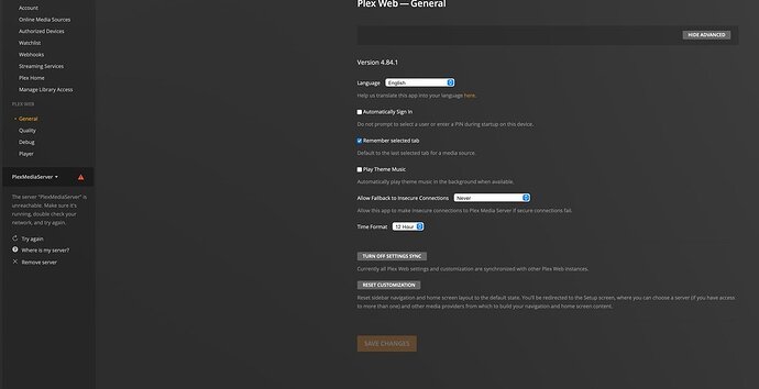

This is a screenshot from server B. This screenshot is from a different computer on the same network. This IS the Docker instance.
All I want to do is setup a new server instead of this one looking for the alternate server. I have tried removing it, however, it still just wants to connect to other users available servers and gives no options to set up a new one.
because it expects a new one to be a different IP. Since you have it so they are the exact same IP. When you sign in it look at your account and all the servers it has access to it sees Server A should be at that IP but it is not so it shows it as unavailable
