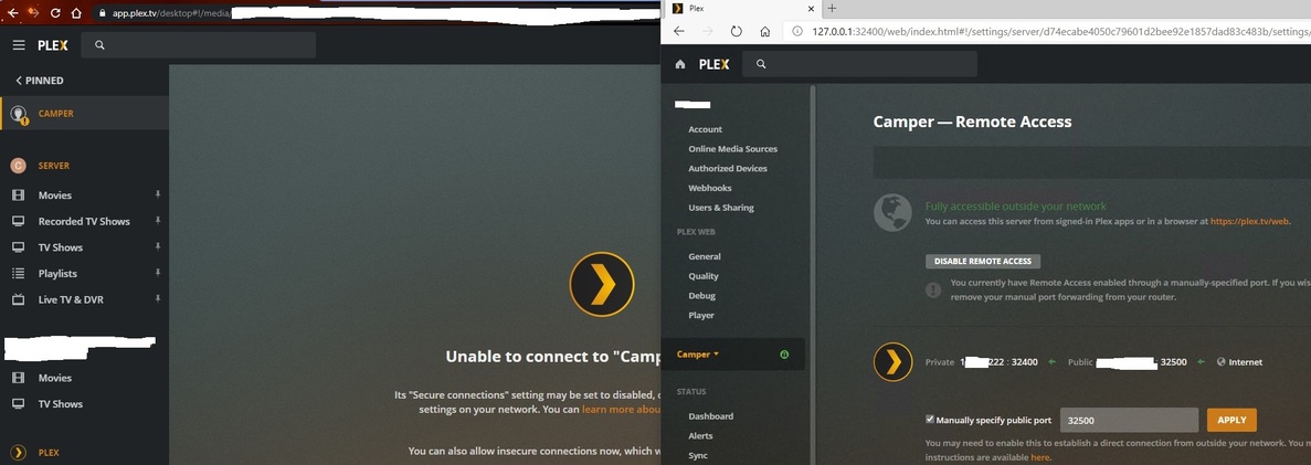

I have two servers running on the same subnet. Everything but Secure Connections is working, This has always been an issue since I built the second server. Any suggestions to correct this would be appreciated, as I’ve been looking for a solution for some time now.
Server #1 Version#: server 1.20.3583 (Ubuntu) port 32400
Server #2 Version#: Camper 1.20.3583 (Windows) port 32500
As you can see from the screen shot server is working properly and camper is not.
Thanks!

Both are set to preferred.
The browser on the left is connected with https the left with http.
What happens when https:// is prefixed to the server 1 url?

Server 1 is https:// which is the issue. I can’t access both servers (server #2) unless I allow insecure connections.
Yea everything works well on the Linux box, it’s just the windows box that is having issues.
