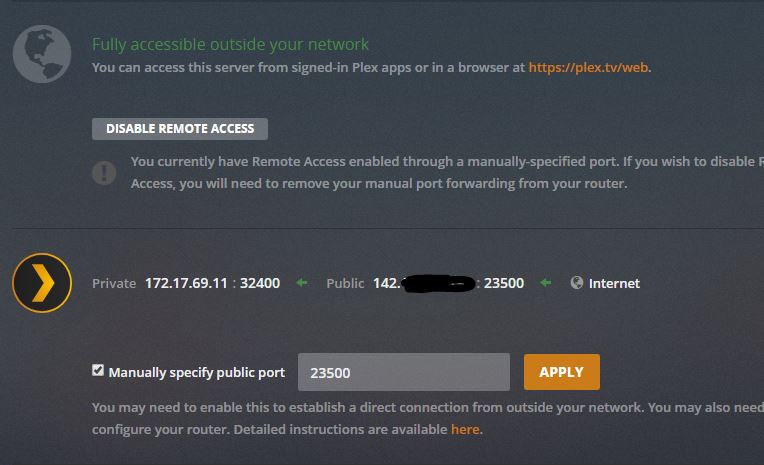

Im a network admin for a living, so i know how to forward ports and verify they are actually forwarded. Pretty direct problem/question: If i set secure = Preferred (or required), then almost all of my remote clients/friends who connected end up showing up as indirect (ie tunneled via plex/aws and 2mbit limit).
I have set the plex server (windows nic) to use 1.1.1.1 as its dns (to rule out dns-rebinding protection, even though that should only affect local network streams, and my issue is remote streams).
Ofcourse plex Remote Access shows as " Fully accessible outside your network" . note i am using a non standard port (im using 23500 -> 32400), and i have verified this is externally accessible/properly forwarded.

Do you have set a custom server URL or a custom encryption certificate?
I do not, please see below for screen shot of the relevant plex settings page
