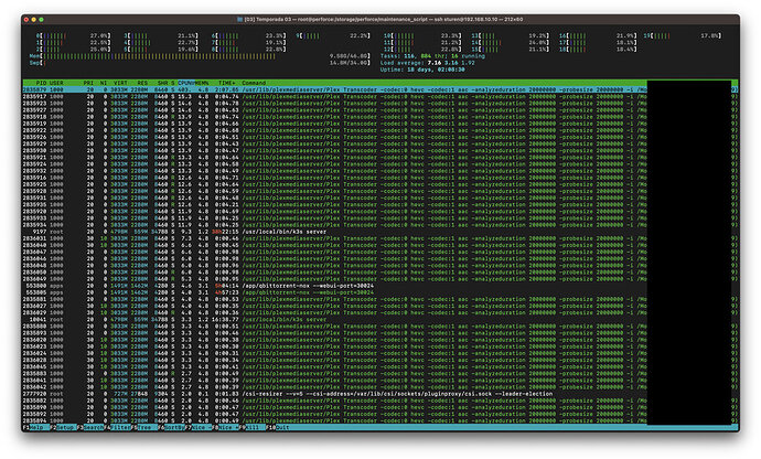

This cannot be diagnosed from a screenshot which looks like it’s been made to analyze a whole bunch of files.
“maintenance_script” ? what’s this?
Is this what you’re doing with it ?

While a lot of people like htop, it also gets them in trouble :stuck_out_tongue: :rofl:
