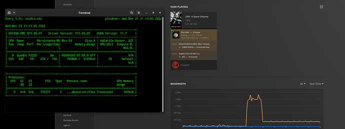

Future reference.:
[chuck@glockner ~.2003]$ nvidia-smi
Wed Dec 21 18:16:11 2022
| NVIDIA-SMI 515.86.01    Driver Version: 515.86.01    CUDA Version: 11.7     |
| GPU  Name        Persistence-M| Bus-Id        Disp.A | Volatile Uncorr. ECC |
| Fan  Temp  Perf  Pwr:Usage/Cap|         Memory-Usage | GPU-Util  Compute M. |
|                               |                      |               MIG M. |
|   0  Quadro P2200        On   | 00000000:07:00.0 Off |                  N/A |
| 47%   40C    P0    21W /  75W |     65MiB /  5120MiB |      0%      Default |
|                               |                      |                  N/A |
| Processes:                                                                  |
|  GPU   GI   CI        PID   Type   Process name                  GPU Memory |
|        ID   ID                                                   Usage      |
|    0   N/A  N/A    705812      C   ...diaserver/Plex Transcoder       61MiB |
[chuck@glockner ~.2004]$

FYI, I uninstalled AnyDVD on my Windows PC, rebooted, installed the latest MakeMKV, and re-ripped the physical media with it. I then moved it to my Linux NAS and restarted PMS with systemctl. I’m seeing the same problem with buffering. But now it’s no longer using the GPU again, and CPU is peaked once more.
This is what Dashboard now shows (no hw, sigh - I didn’t change a single setting in PMS, just restarted it) :
I just rebooted the system and now PMS is back to doing this :
Ie. it’s doing hardware transcode again. But unfortunately, still buffering.

I really think there is a bug here, probably multiple bugs .
  1. PMS dashboard should never show 10 Gbps as the bit rate. That’s the speed of my Aquantia NIC on the Plex TV client at 192.168.1.3, not the video’s bit rate. The Linux server hosting PMS at 192.168.1.50 also has the same Aquantia 10 Gbps NIC.
  2. PMS seems to sometimes use the GPU for transcodes, sometimes not, without changing any settings on either client or server. Rebooting the system that’s hosting PMS fixed it twice. “systemctl restart plexmediaserver” would not fix it, only a reboot did.
  3. Even when PMS does successfully use the GPU for transcodes, there is still buffering on the client.
I’m not worried about bug #1 - that’s a display issue, most likely.
Bug #2 is very annoying. Bug #3 is a showstopper, though. I can’t transcode the movie at all, with either CPU or GPU.

The most obvious difference is the Nvidia driver version
I have had other users experience problems with 525.
They also had to rerun updateinitramfs -u and reboot after downgrading.
Has the machine been rebooted since 525 drivers installed ?
