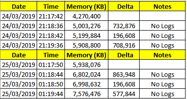

I have looked at the logs and the memory snapshots and it does appear to be similar to the EPG refresh issue investigated in this topic Non-responsive after 1.15.0.659 ubuntu upgrade - #74 by sa2000
It is possible that XMLTV EPG Refresh has more demand for memory than the normal refresh. The following shows the increases
This shows the increases during EPG Refresh
and earlier on (no logs available)
