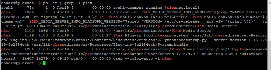

Also, please include ps -ef | grep -i plex console output

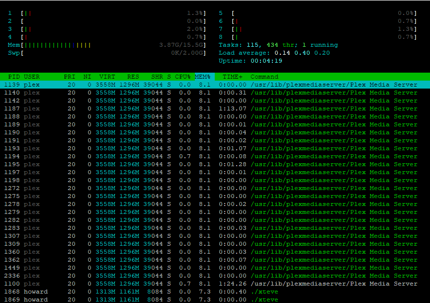

Here are the logs and screen shot immediately after a restart.

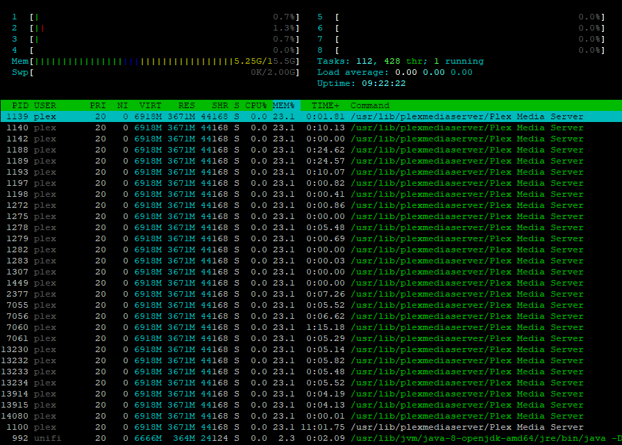

And then here is the logs from this morning after running all night. Can see the memory is slowly starting to fill. It was overnight so there was almost no activity.
I’ll send another tonight after work.
Plex Media Server Logs_2019-04-20_09-18-36.zip (7.1 MB)
And then here is the console output:
htop is showing you threads. There is no gain. Regular pids is more than enough. ps confirms this.

Here’s the current htop.

please don’t use htop? regular top is fine.
also free -m and ps -ef work even better. No screenshots required.
hahaa ok. I’m just used to htop.
