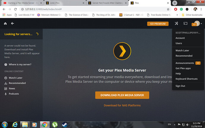

Same here, except all I did was download Plex and it booted up fine I put my media on it watched and enjoyed for 1 day, then I went back to watch some stuff last night and it gives me the ‘Searching for Server’ message. I have cleaned the program and all related files from my desktop 3 times, so far, and This message is all I get for the time spent.
I am not very skilled with the science of computing or the language of coding. I will need a layman’s solution. Thank you for your time.
You have cropped the screen so i cannot tell how your are getting to your server - whether through http://127.0.0.1:32400/web or https://plex.tv/apps/desktop
I can not see any server linked to your account.

Hello, I am getting to the server through: http://127.0.0.1:32400/web/index.html#!/settings/web/general.
I don’t see a Plex icon in the bottom right corner.
When I went to Users there was no xxx/AppData file.
And the IP is not one of those non-standard “192.168…etc…” types of ip. This is another image that includes the cropped material along with the view of Task Manager.

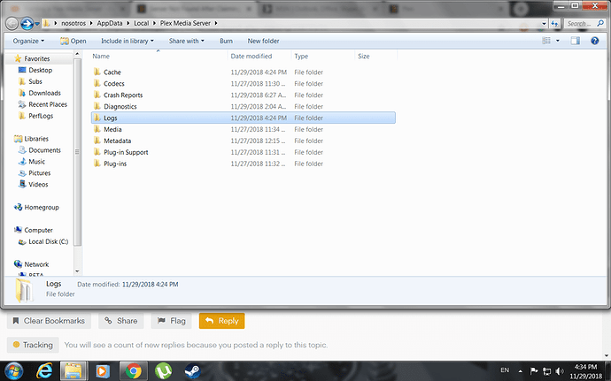

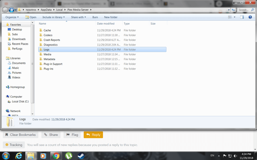

The AppData is a hidden folder
Type this in the run box
%LocalAppData%\Plex Media Server
and see if there is a Logs directory visible
On the Plex Web screen top right corner -which account are you signed into?
Yes, there it is. What do I do?
I am signed into my account? Maybe I don’t understand. scottdp@live .com. is the only one I have.
That is not true
I will send you. Message with the account the server is signed into - which is different and hence you are not allowed to see it !
What is going on then. I only have this computer.
Well let me see if I recognize it, then…
Oh… That’s my other hotmail account. Crap!
Well now I’m on my other account and it says the same thing.
I’m just going to delete the accounts, and all the files on my hard drive and start over. Thanks again for your time.
Can you message me exactly what account you are signed into - it is not gmail
