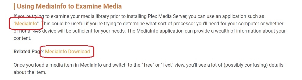

https://support.plex.tv/hc/en-us/articles/201998867-Investigate-Media-Information-and-Formats
On that page ^ linked right there ^ is a link to the MediaInfo page:
…not once, but twice - that leads right here:
https://mediaarea.net/en/MediaInfo/Download
wherein one would assume a pasted report that ‘looked like’ a MediaInfo report would be a MediaInfo report (especially if ‘one’ were as sick as I am right now).

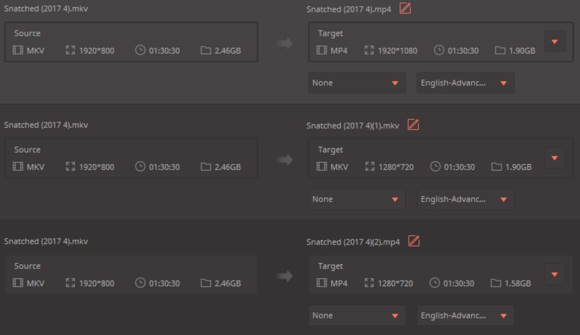

So, I’m playing around with different conversions. I got a file that gives me this error, so I converted it 3 different ways.
When I add them to plex it looks like this:
All three of the new videos play. Great! I delete the original and the 720p mp4 and mkv and keep the 1080p mkv.
I do a refresh and now there is just one listing and it doesn’t play any more.
I undelete the files and try again. with each one, when it doesn’t have the metadata attached to it it plays. As soon as I delete the others, rename the file if needed, the server all of a sudden can’t play it anymore. This is beyond frustrating!
I rename the original file so the meta data doesn’t match and IT PLAYS!!! WTF!!!
there are no other files in the directory. I deleted the .srt that was in there.
So I tried this with 4 other files. I just make a copy (ctrl-c, ctrl-v)“movie - (Copy).mkv” and now they all play. This is total BS!
First one doesn’t play, the 2nd, a copy, plays just fine.
I’ve come to the conclusion that there isn’t anything wrong with any of the videos I have they should all play just fine and they do as long as Plex doesn’t know what it is.
Any help here? This is pretty stupid.
