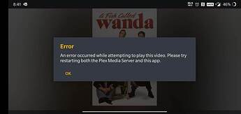

I’ve been unable to stream over mobile data from my Android device and recently started having issues with a Fire Stick. It’s not absolute, from time to time I am able to stream on the Android, but it’s rare, the Fire Stick seems better. I am always able to log in and see all the content on the server and remote access reports that it is accessible outside my local network, I’m on server version 4.30.2, the Android is 7.30.0.16390, and I’m not sure what the Fire Stick is running. This is a new development, I’ve been able to stream on anything remotely up until a week or two ago.
Below are logs that show a snippet from the console of a successful stream on wifi and an unsuccessful attempt on mobile data. I’ve also attached screen shots of the errors trying to stream over mobile data.

The suggestions in the linked thread didn’t fix it, it also seems like a different problem, I have no troubles streaming locally, only remote. The server is accessable and I can see progress and New files as they change. I thought it might be a transcoding issue, but that would show up regardless of being local or remote correct?

I’ve done a bunch of testing and I can’t figure this out, sometimes after a server reboot everything behaves fine for about 30 minutes, but not always. Sometimes if I log out of the remote app and back in it works for a while, but not always.
I’ve had a bit of a breakthrough this morning, I’ve installed the plexamp app and that is working remotely for music, while the main PLEX app is not. So I think the problem is in the Android app, not the server.
