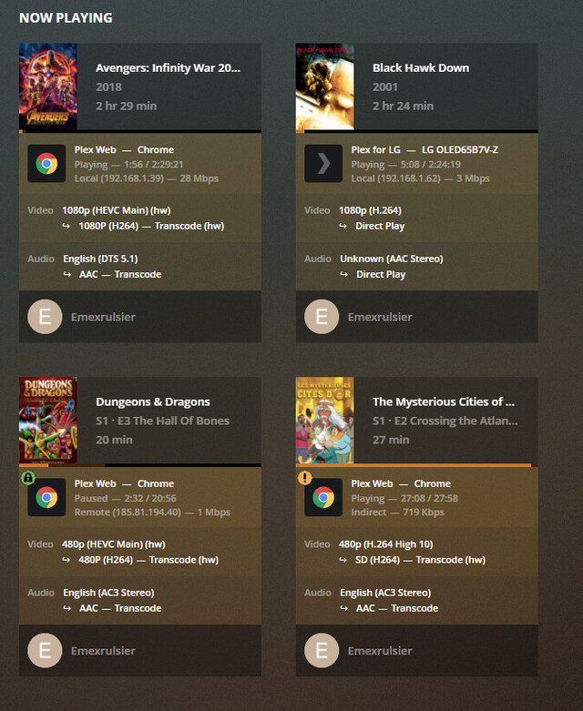

Those icons have different meanings and are not necessarily related.
The key information can be found in the 1st section under the poster (the “line” with the player icon):
  • Avengers is playing Local via Plex Web running in Chrome
  • Black Hawk Down is playing Local via Plex on your LG TV
  • Dungeons & Dragons S01E03 is playing Remote via Plex Web running in Chrome
    The additional lock icon identifies this stream is using a secure connection
  • The Mysterious Cities of … S01E02 is playing Indirect via Plex Web running in Chrome
    The additional alert icon identifies exactly that… this is an indirect stream and you might want to look after why that is.
