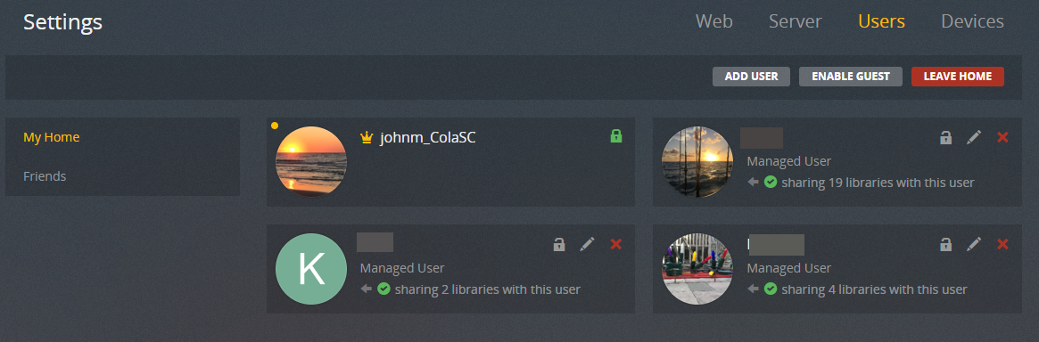

Can you show screenshots of the user screen and then screenshots of each Home User Restrictions tab that can’t access Live TV? For example:
I’m not sure if you can see this
Screenshots of your users (My Home) and Friends sections? Similar to below:
My Home
Friends
See the requested screen shot
Friends do not have access to Live TV. Only My Home or Managed Users. See the Allowing Plex Home members to watch Live TV section of the Watching Live TV support article.
Sharing live TV with ‘friend’ accounts is not supported.
The checkbox will only appear on those accounts, which are listed if you click first on the category ‘My Home’ on the left side.
i.e. only ‘managed’ users and friend accounts which have been invited additionally into your Plex Home will be able to use the live tv feature.
If there are no users listed when you click on ‘MyHome’ then no user except you can use live tv.
