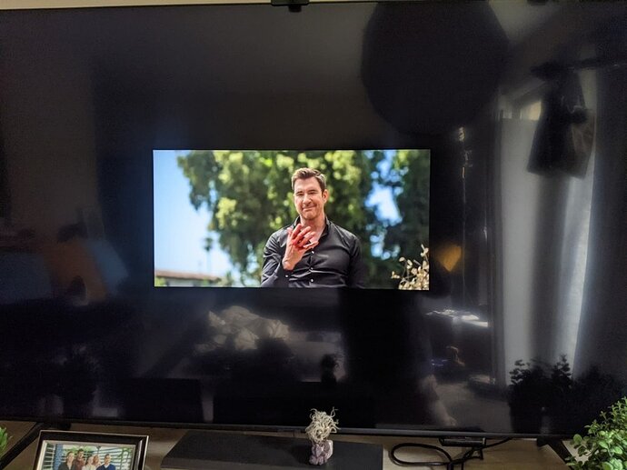

It seems too that some things randoly play on only a tiny amount of the screen (see attached photo). Again, something that Plex on Roku never did.
The above is a 4K file that’s being transcoded at 720p (which, again, never happened with the Roku I had … and there were no settings to adjust to get it working).
