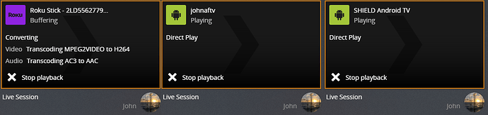

I’ve searched around but not seeing a thread on this. Basically I’m just wondering if the shield tv (as a client) handles direct streaming for live tv and if that makes it a superior choice. Right now I am using a Roku as my main client, and live tv (especially sports) is sometimes choppy. I do also use an xbox one on a 2nd tv and that seems better. So I am debating upgrading my Roku and am thinking the shield tv seems most optimal as my understanding is it has the codecs necessary to eliminate any transcoding at all- is that true? I my plan an awesome plan?

I have both the Shield TV as well as a Fire TV and Fire TV Stick. I am able to direct play any content, HEVC encoded recorded TV Shows/Movies and Live TV on any of the three devices with no server transcoding. My Roku Stick requires transcoding for Live TV. See screenshot below where I am watching the same Live TV station. As you can see the Roku Stick is transcoding while the FireTV Stick and Shield TV are both Direct Play.
