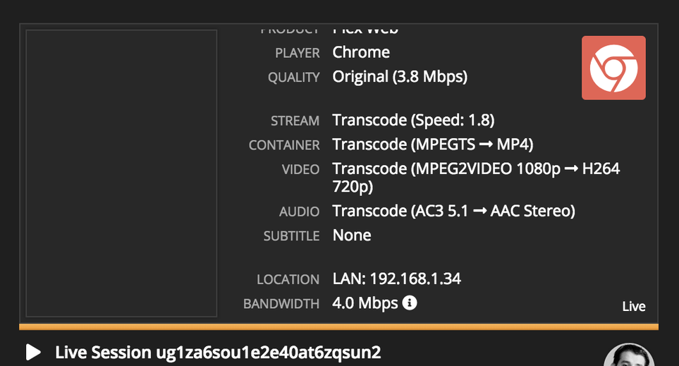

Yeap some tuning required there. For example check this out. Here is PlexPy reporting bandwidth requirements (and transcode speed). For playing an uncompressed feed from a broadcast channel at original quality (1080p) and then the same at 720p. My setup seems to be able to keep up with the smaller feed much better (both server, client and network). Of course if you have an 80 inch TV then you might want the 1080 feed because your eyes can pick up the pixelation but my TV is 42 inch and I can’t tell the difference at all.
