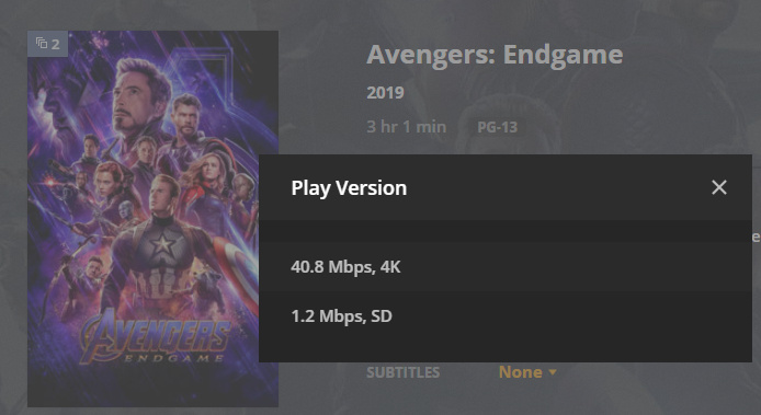

I will say, I have most of my media configured where I have an HD and SD version of a file, therefore (for the most part) Plex does a good job of choosing the SD file and uses Direct Play. There are some instances where it still has to transcode, but it primarily transcodes that SD file so it’s not working too hard. When my users stream Live TV (from a HDHR Quatro) it always transcodes (audio + video) and they report having no issues.
I think part of why my setup works so well is because I’ve done a good bit of media curation to make things as compatible as I can make them without sacrificing picture/audio quality. (Note I re-encode my stuff to x265, which is not always supported on players, and transcoding works without issue.)
Is your “SD” version just the compatibility function in plex or do you have (2) movies of the same type? I have all my movies coded as x264, I didnt think about changing to x265.
I have two files of the same movie. So for a 4K blu ray I do a straight rip of the 4K, then compress the regular bluray in handbrake to a 480p file exclusively for external streaming.
For most of the blu rays I have done, the SD file comes out to 1.5GB max, so I don’t mind taking up the extra disk space. If I need more space, I can always purge those SD files.
