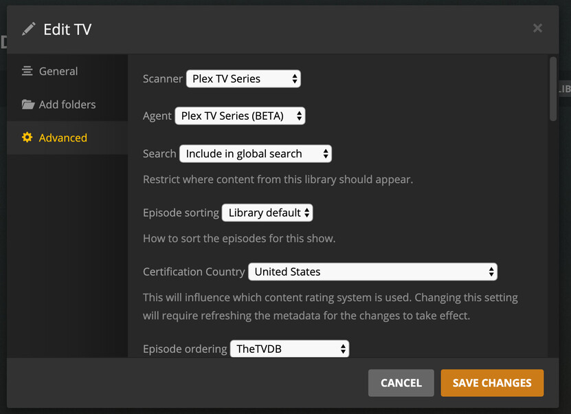

Here are my current scanner settings. I changed to the beta a couple weeks ago in an attempt to fix the issue, but it did not help.
You will probably need to also upgrade the library to the new scanner. See the options in the popup when you select “Manage Library” - there should be an “Upgrade Matching” option
I’m not seeing the option you are referring to
Just double checked - that option will appear in version 1.23.x - I thought it was out already
I expect Refresh All Metadata library action to upgrade the matching
Ah okay.
I did try the metadata refresh and rescanning library files, but I’ll do it again, just in case.
No change
