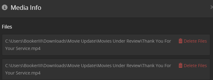

Basically, once the item is scanned in my library location, plex is creating 2 files for the 1 file in the library. This is a screenshot of what I see when I check the file details in plex:

Thanks for the image. It looks right, you only have the 1 folder.

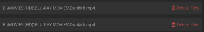

Just happened again with “Dunkirk.” This is a title that was correctly synced, moved to a different folder on a separate hard drive and didn’t sync at all. I then removed it and tried it again and the duplicate issue returned. Logs attached. There’s no rhyme or reason around it. This has nothing to do with the title being moved to a different HDD because the original files that duplicated were all being plex danced and moved around on the same HDD. Tonight’s attempt is what I’ve been seeing for weeks now.
