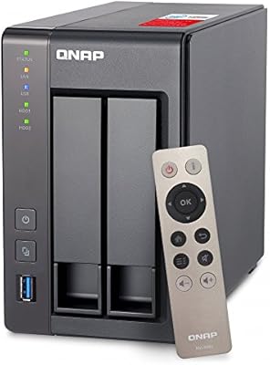

BTW: I’ve never seen any sort of storage that connected via HDMI. I wonder if they were expensive because they had processors and ran software and weren’t “just a disk”?
WD media players did and some QNAP NAS currently do and start at around 300USD
