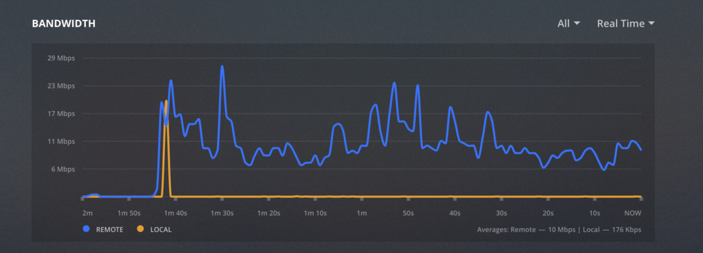

I run a Plex Media Server version 1.15.2.793 on Xpenology in a ESXI environment which is capable of up to 80mbp/s bandwidth.
For remote users who connect to my server who’s broadband provider is with Virgin Media they seem to only be able to connect to it at around 10mbps which causes the content constantly buffer when doing direct play.
If other users connect to the Plex server who are not with Virgin Media they don’t seem to be restricted as you can see from the screenshot below and can go over 30mbps with ease and there is no buffering on any content. From the screenshot you can see the user who is with Virgin Media streaming at around 10mbps and the large spike when it hits 40mbps is when another user who’s broadband provider is with BT.
My question what would cause this? Is it a problem with my server or is this a problem with the broadband provider.

Hi, allow me to add some more to this: I host a server on the same network as @pranaypancholi (our servers are not on home networks) and am one of the Virgin Media users he mentions. I can happily run 2x 25mb/s streams to clients on my home network from my server on the same remote network as his. But I can’t stream much over 10mb/s from his server.
The servers are both located on a remote network with very high bandwidth and low latency, far in excess of what we have available on our home networks.
I can’t figure out why VM users get such poor throughput from his server while mine works fine, while BT users get great throughput from his ¯\_(ツ)_/¯
