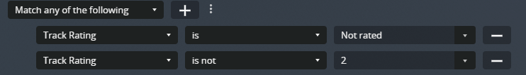

The Smart Playlist filter “Track Rating” uses a dropdown menu to select ratings 1-5 star, or “Not Rated”. Having an “Not Rated” option is important, as using a filter such as;
"Track Rating - is not - 1 star "
will exclude all unrated tracks.
Therefore the two filters in the screenshot below are require to create a playlist of all non-1 star tracks - (exclude 1 star & reinclude Not Rated)
However, the filters “Album Rating” and “Artist Rating” use a 5 clickable star system in the filter, which does not allow for an “Not Rated” option; while “is not - 1 star” still excludes “unrated”. (Leaving the clickable stars unclicked does not work to assume “Not Rated”).
Different Smart Filter rating systems shown below;
Because of this, I can’t create a playlist that excluded 1 star Artists, 1 star Albums and 1 star songs but does include all Not Rated music
As such, I’d request Album Rating and Artist Rating use a rating select dropdown to allow for an “unrated” option; or that the “is not - ‘X’ stars” does not exclude Not Rated items
Tangentially, changing the star ratings to numerical values from -1, to 10 adds unnecessary confusing when looking back at smart filters (2 in the above screenshots signifies “1 star”)
There is a non-zero change that I’m an idiot and have missed something; either a feature add, or showing me I’m an idiot is appreciated.

Unfortunately, those filters allow unrated songs from “1 star” albums (or artists) though. (Apologies if I was unclear about what I was looking for in the filters)
However, being able to select “unrated” for Album/Artist has allowed this filter stack to work
