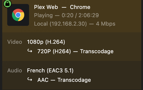

For a 4K HDR media, transcoded to SDR 1080p 8M, Plex show me this:
And tautulli :
In the log I’ll provide bellow, I can see :

THis is with or without tone mapping :
Or with a x264 video :
