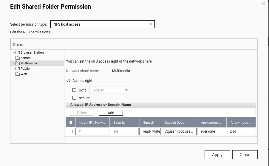

Can you please show me the NFS settings for the shared folder (screenshot from where you set it)

Here is the info you have requested (hopefully I have the right pieces)
NFS settings:

You are using sec=sys on the QNAP.
