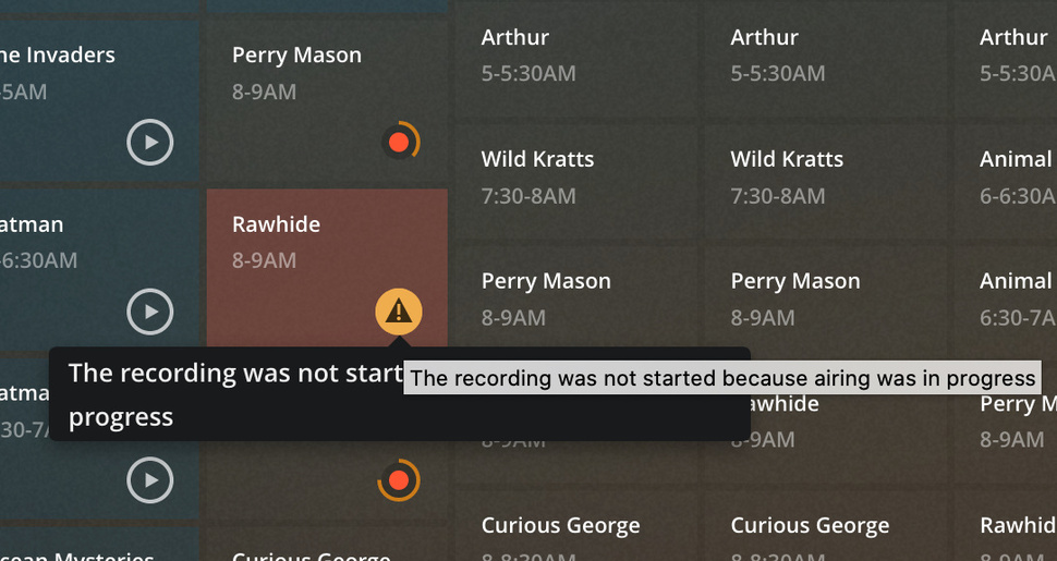

I have “a lot” (?) of recordings scheduled. It’s not uncommon to have 2 concurrent, and a few times a day 3 concurrent. 4 is rare, but happens.
Sometimes one of the recordings fails and reports ‘airing was in progress’. One particular case is when 3 shows are ending at the same time and 2 are starting immediately after. I’m sure there is some amount of delay between ending a show, releasing the tuner, and starting the next. However, I purchased a 4 tuner device so I could do this many recordings. What is the allowed time for releasing the tuner and allocating to the next?

The other error, failing to record because the airing was in progress, comes about five minutes later when it attempts to restart the recording:
Oct 05, 2020 08:05:41.434 [0x7fe34a7fc700] DEBUG - Grabber: Operation for 'Rawhide - E18 - Deserters' Patrol' on channel 6.3 completed with status error (The recording was not started because airing was in progress)
Oct 05, 2020 08:05:41.434 [0x7fe34a7fc700] WARN - DVR:NewSchedule: Couldn't schedule recording (error: The recording was not started because airing was in progress).
Makes sense now. I thought that if the recording couldn’t start because the tuner couldn’t get a signal, I’d get the first error about the tuner and it would remain on that error. I didn’t realize it would try again and then report the ‘airing in progress’.

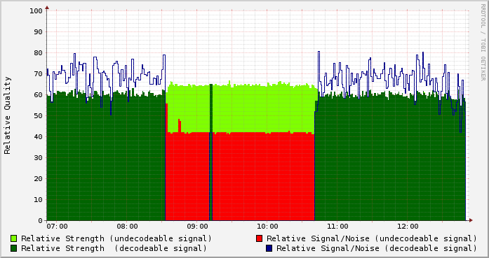

I see some signal problems for that station on rabbitears.info. Not sure if the time zone is correct on the graph, but definitely something going on.
