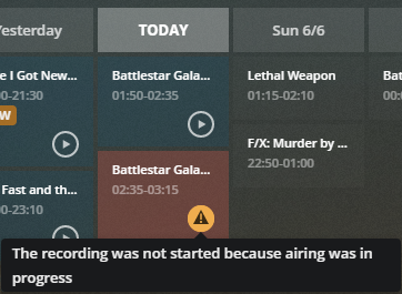

This is strange. I’ve got 3 tuners, but this morning I noticed 1 of my recordings failed with the message, “The recording was not started because airing was in progress.” Only 1 tuner is in use at the time of the error. Why would it think that the airing was in progress? They are 2 separate “airings”.

This also happened to me in the small hours of this morning trying to record the two episodes of Battlestar Galactica that are shown weekly (back to back) on BBC2 HD:
Airing was in progress
The first episode recorded okay but the second did not :frowning:
Like others I do have Allow partial airings disabled.
I’m using a HDHomeRun Connect Quatro (HDHR5-4DT) and no other tuners should have been in use at the time.

Inspect the details of the two airings in the EPG.
If there are no further details in there which allow Plex to differentiate the two, it will assume that the second is a re-run of the first and thus won’t record the second.
Cheers… I believe Plex thought the two episodes were:
  • S4 E15 - No Exit
  • S4 E16 - Deadlock
