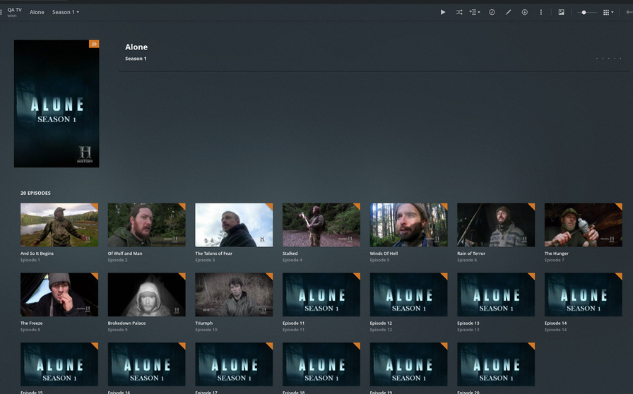

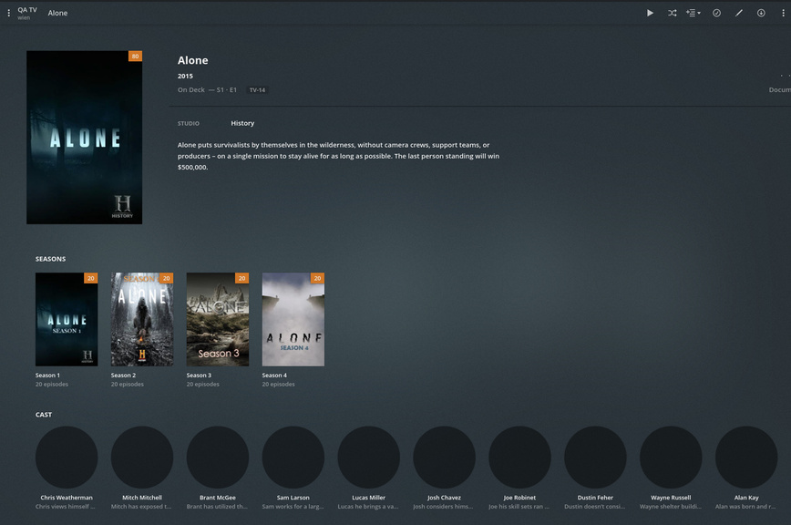

The series page presents;
Season 1 presents me with, which implies there are only 10 episodes.
