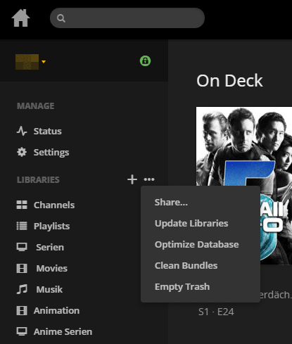

Is it possible that you disabled the ‘clean bundles’ operation under ‘Scheduled Tasks
or that your server device is off in the designated maintenance hours and so
the cleaning of bundles never happens on your server?
If that is the case, you might wanna trigger it manually - once a month or so.
(It may take several minutes to finish, particularly when it was never performed before.)
I don’t think so. I’m not sure how I would confirm this though. I’m certain that nothing was mismatched as the new movie at the time that I added it, because I had previously searched for it and did not find anything.
A ‘clean bundles’ would take care of that.

  • Perform ‘cleaning bundles’
  • stick to the naming guides
  • Let your server perform its maintenance regularly
