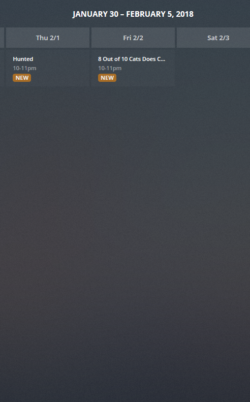

Sometimes when I schedule a series to be recorded, they don’t show up in the recording schedule and don’t get recorded. For Example, this show that has an airing for February 1’st is set to record:
However, when I look in the recording schedule for that date you can see that the show isn’t showing:
If I go back and cancel the series recording and mark the individual episode to record, it does show in the schedule (There appears to be another bug here in that I have to reload the page after cancelling the season recording to schedule an episode recording otherwise I get the message “There was an unexpected error”):

Problem 1: Without seeing the logs to see the messages displayed when the show is being analyzed for episodes to record I can only assume that in the recording settings you selected only “New” episodes instead of “New and Repeat” episodes. From your screenshots the surgeons episode you set an episode recording for does not show “New” under it like the “Hunted” Series you have scheduled.

Thanks for your reply, and you were completely right on count 1. The issue was indeed that it was set to record only new not new and repeat. I naively assumed that new and repeat allowed it to re-record already recorded episodes, however, it appears as though it actually only records completely new airings. Oh well, lesson learnt.
