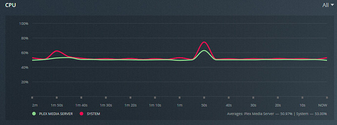

Now the scan does not seem to be happening (no spinning wheel as before) but the CPU is pegged at around 50% with a few spikes jumping all the way to 100%. Is this normal? I’ve tried to initiate a normal library scan but still no spinning wheel. I can easily stop and re-start the server if that could help? any advice will be much welcomed
50% CPU generally means sonic analysis is happening. Make sure you access via https://app.plex.tv and you can see the progress in the top right status.

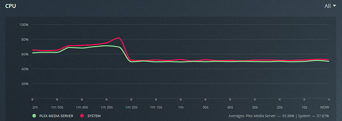

This is the CPU dashboard:
Hold on! I thought I’d check in another laptop and there you are, the wheel was spinning and counting. So I signed out from this computer, closed and reopened the browser and here it is:
The process was stuck at 855 albums before, now it is at 692. I’ll keep an eye on the progress and report back.
