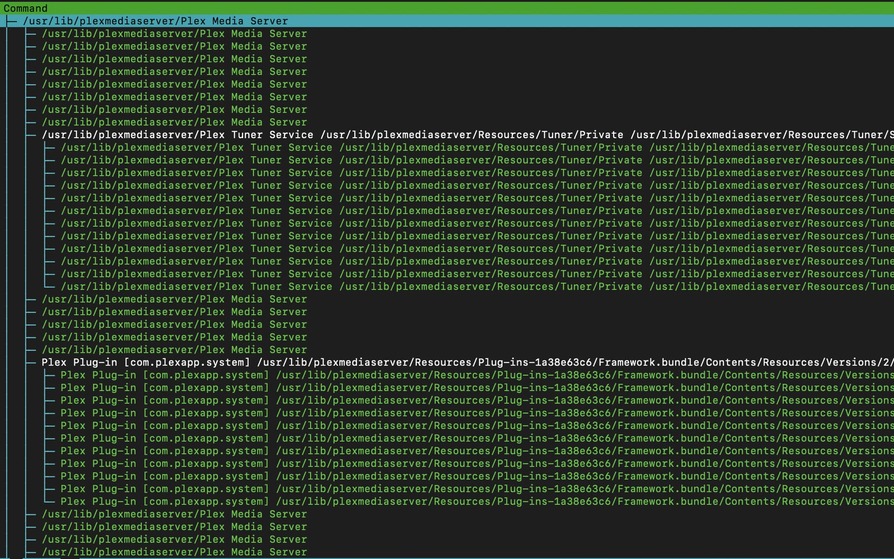

I tried looking for that, but unfortunately there are no instances of Plex Transcoder running at all:
Beats me then, hmm. I hop you figure it out. There is a lot going on in this analysis, not sure where the next weak link is.
