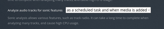

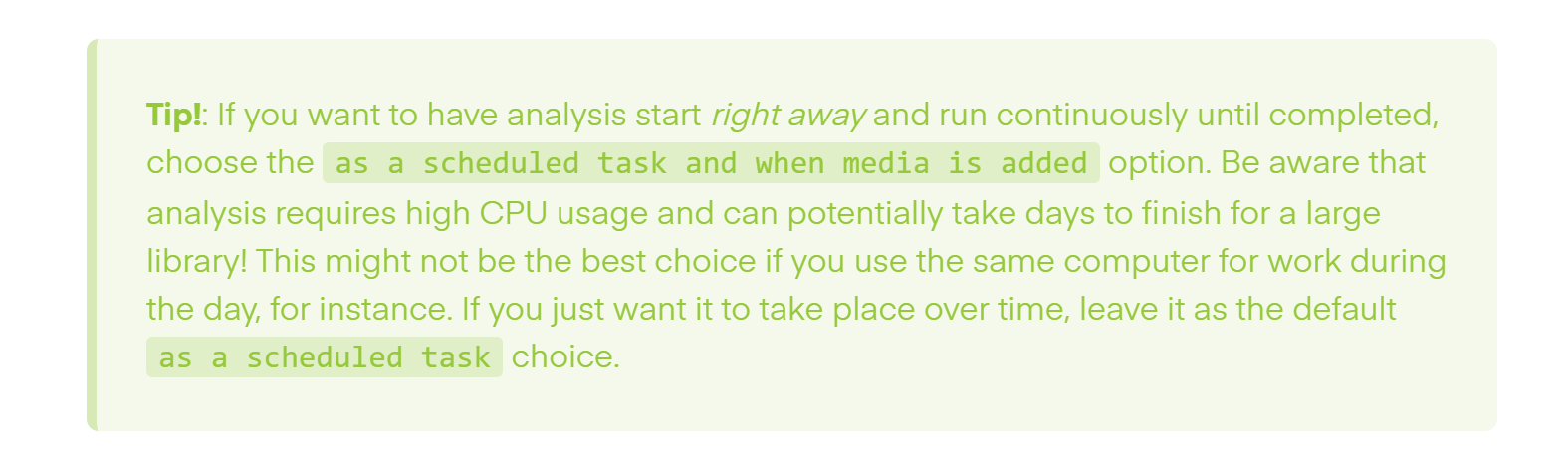

Just saw this tip on the support article ( Sonic Analysis for Music | Plex Support. Will give it a shot.
After turning up the logging yesterday, I now see that something was, indeed, going on behind the curtain…
Apparently it was running as a scheduled task but was NOT running when adding new music to the library.
