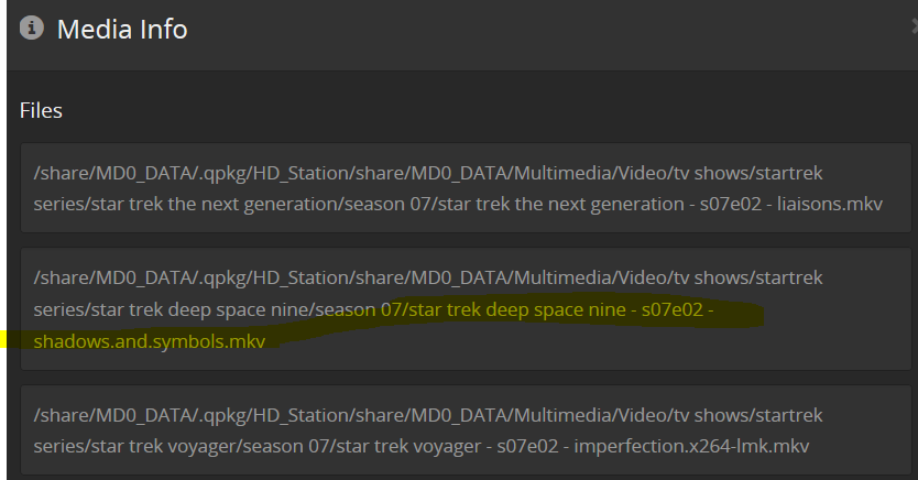

Plex has an issue getting the correct data for my Star Trek series. I have tried all suggestions I could find via Google search, however it seems Plex is still mixing things around.
In this example the correct link would be to the Deep Space Nine serie, however it has 2 additional links to other series, which is strange.

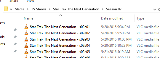

I believe the subfolder “startrek series” should not be there. Plex expects the show folders to be listed right after “tv shows”. Your setup may be confusing it. This how I have one of mine and I have no issues…
Hmmmm, that is one thing I did not try. Let me do that and I will revert after the re-scan is done.
Thank you!
@tghowe: your suggestion worked perfectly. Many thanks again!
