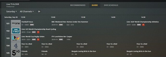

My postcode is DL6 its the Tyne Tees area in the UK. I’ve included a screenshot showing 3 live sports events on BBC1, BBC2 and ITV.
I’m using XMLTV file created from Schedules Direct. This is the TV series that plex would match them upto Live
Hope this helps.

On the Plex EPG - the titles are slightly different so this specific example of incorrect matching would not arise
