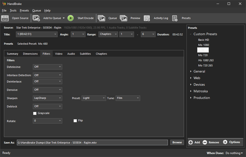

I have made a few adjustments since that guide…
the LapSharp Filter is ‘Light’ with a ‘Film’ tune - unless, of course it’s animation…
I may have raised or lowered the bit rates some - but you should be doing that anyway… I do recommend you try my rates and view honestly - then adjust from there.

I did this one fast and dirty. Not for archival / replay purpose.
It was not interlaced. Missed that question. Sorry bout that.
Yea, that doesn’t look bad. It’ll play on ‘newer’ stuff - probably.
Get a new Handbrake - the latest is 1.3.1
Now make a proper DVD encode with these settings:
The AAC 2.0 audio is fine - that’s as compatible as it gets.
Interesting that Handbrake didn’t detect that there was a new version. I even checked for updates in the software before I ran all this. Thanks for the tip. I’ll go grab that, and then config HB with those settings and let it tool round the bay for a bit. Back in a bit. :slight_smile:
That thing should fly through your system (they have wings on mine…lol)
don’t forget the 2 pass with turbo… when bit rate starving - it’s a must and goes a lot faster than you think. <—but worth every minute of it.
I’ll be sure to tick that. Thanks. :slight_smile:
Currently encoding at avg fps of ~160. Rough time of pass one completion from start to completion is 15 minutes. 2nd pass should be roughly the same, so about 30 mins start to finish.
Your machine is doing well.
Notice my ‘Dimensions’ tab.
I had to counter HB’s Autocrop a bit to get the ‘853’ back (standard 16:9).
I stick with Auto, but check and fix as required.
HB goes a little crazy if there are dark scenes - so check it - always.
Letterboxed items won’t be ‘853’. They’ll be whatever they need to be, but always maintain the ‘480’ Height. That’s all the resolution you got - so get it all.
Ok. I’ll have to watch that better. I stuck exactly to your numbers. Now I understand it better. Next time… :slight_smile:
After a short while you’ll know what the ‘Width’ should be.
4:3 is 640 <— and you can even sneak a bit of Height to get a bit more width, but don’t chop heads - if you know what I mean - and don’t lose that 480.
16:9 is 853
Super Widescreen (you know) is 1152
Super Duper Hateful 8 Widescreen is… whatever it is, but get that 480 - no matter what.
Just under 40 minutes to complete. Forgot the 2nd pass isn’t turbo.
